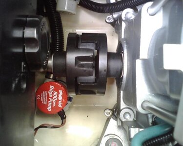

my never airlocks
the only thing mine does is once it has about 1.2 inch in the hull it cant suck anymore up so it goes chchchchchchhc and then you turn off and a lil more water comes out. my still leave about a 1/2 inch in the bilge looking near the tank and cases. i run the line strait and then make it run on top of the elec. box then out my out is a little lower than where the electrical box is to help with filling the hole when normal ridding beaching and ect.
on occasion when i am ridding after a sub or somthing where i know i have water to bilge out, if i turn it on and nothing then i usualy go off and then back on and it gets it or it doesnt and water didnt enter or need to be bilged. i have a thumb on off switch by the start stop switch so its easy to on off.
by the way is it bad to ride with it constantly on or would that be bad. like running a garbage disposal with no water.

so my way works and has always worked its that the thing doesnt get all the water out. when it gets all it can it goes chchchchhc.
and hey how is my coupler spacing.

your coupler spacing is fine... and I didnt write the guy at Rule about getting all your water out... I wrote him about getting your water out and not having your pump airlock like yours does...
