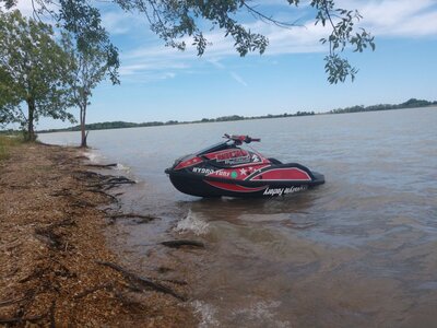

Stripped the driveshaft and impeller the last time out in 2018, so now it has an stx 12f driveshaft and a new coupler along with a new impeller and it is back running again, made a whole day at the lake with only the handlepole bolts coming loose.
