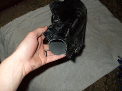

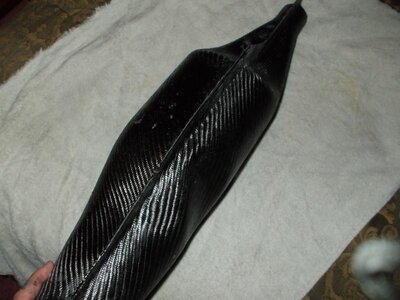

Fused togather today.Im playing with a coating on the inside,its a prepreg stainless hightemp coating.It does work,if u heat the inside with a heat gun it takes twice as long to get hot vs no coating.There are 3 coats and its strong stuff.Its made for plastics and resin so its sticks well.Not cheap and its for aircraft use.Next step is triming down the pipe and wraping it one more time with 4x4 then the last rap of kev/carbon hybrid cloth.
