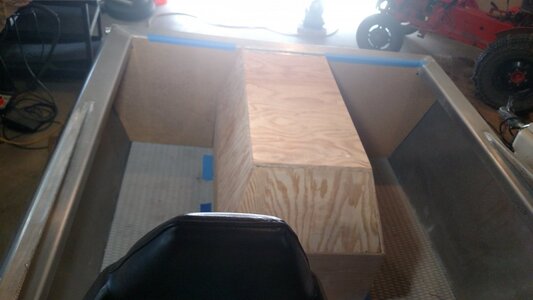

Engine Cover:
This is is a concept made from some marine plywood I had laying around. Its taller than it needs to be but that allows me to hinge it in a way that I can flip it all the way out of the boat for service. I think Ill sink a storage locker in the back of it where theres extra room. I feel like it should be aluminum in the end but Im not sure. I may cover it with material and run it or perhaps use it as a mold for fiberglass. For now its there and helps cut down the noise which still is pretty high. Comments welcome.

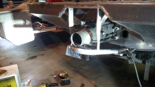

Pump Guard:
I slowly went over a really big log last year and cracked my steering nozzle last year. Lucky that was the only thing. I knew I needed a skid and that confirmed it. A friend of mine has a tube bender so we made this hoop under the pump. So far its been doing the trick. 1.5" x .125 wall tube.
![IMG_20190411_220236952[1].jpg IMG_20190411_220236952[1].jpg](https://www.x-h2o.com/data/attachments/289/289088-7bf2e3b85ba56a97a265d3e90276f980.jpg)
