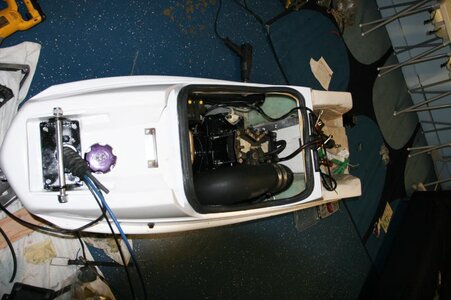

some picture of fitting the engine with the plates and pole bracket. really happy with the way it sits everything lined up perfect need to drill and tap some holes and the pretty much the whole ski will be going back together..
seattle
some updated pictures have everything mounted up now pretty much needed a giant shoe horn to wedge that motor in there. getting real close just have to still hook up exhaust outlet and pissers then time to start it up. cant wait, time to finally ride again.
man my motor is about 3 inches more forward than yours. I need to find another shaft to cut down and make new mount plates just incase I need to get mine back this far. How soon until you expect to ride?
seattle
well, 99% done just waiting on turf to get here then i will be riding probably next weekend. cant tell from the crappy pic but the pole is carbon wrapped.

i just picked up a 300sx myself and will be starting on a build soon, just wanted to complement you on a sweet looking ski
seattle
right on, this is the third time i have done a build with one, they are a fun ski to modify i think. post up your build on here so we can check it out.
looks great man, it might be a race for who gets to the water sooner. Im just about to epoxy in some tapped aluminum blocks for the tank straps to hook to, after that its down to a battery tray and im done. I love the nose on this. what are you doing for a tow hook up front?
