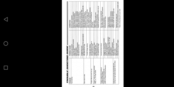

I built a 4mil stroker with case porting and port matched sleeves bored to 760. Should be around a 800cc. On daul 46s with 18pai 2.3 135 low and 190 high and still to lean
I have a learn spot when hit wot. Was going up jet sizes all the way from 120 to a 190 even to the point I removed the jet and still it's not rich. It still pulls on 3 turns out on high speed and no jet at all. If even bypassed fuel tap and filter and still no luck
There is no air leaks engine holds 10psi over 30mins and only drops in 1psi over that time.
I have tried 2 sets of 46s even bought a brand new set. I ran my first set with 60 return jet in line. And new set are bone stock. Still the same symptoms. Engine runs ok on the 38s but feel more power to be had out the 46s.
I read a lot about fuel pressure and people are going up jets to 90 in the return line. But my carbs give a learn symptom not rich. Is it possible the fuel pressure is to high at WOT and matching my pop off pressure as it set low at 18psi on 2.3 ns. So not opening the needle fully.
I'm stuck been going round in circles for long time now and licoriceed off.
