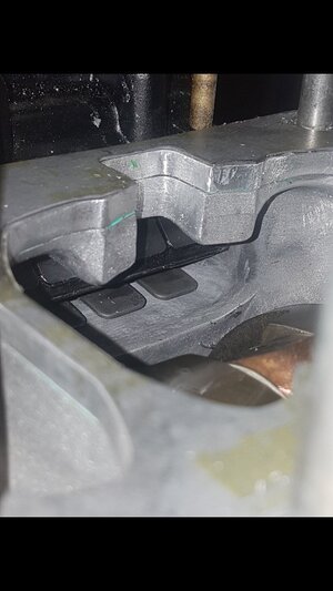

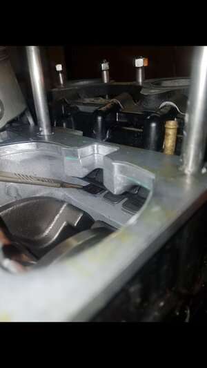

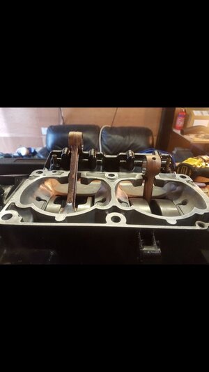

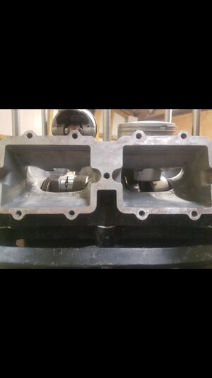

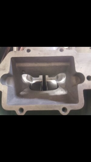

Is was my next question. I'm running a protec mani that has the cross over. Will the cross over effect the carb signal. I have also been told my case porting quite large. I think I may have a carb signal problem.
I have tried 1 high speed check valve now. And 3 flame arrestors to hopefully get better manifold pressure. Still the same. Do people think this case porting is too large for my application.

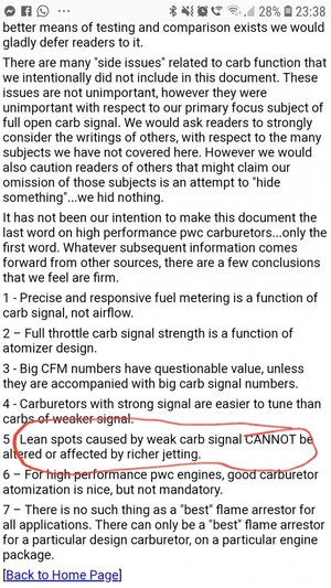

From whatbim reading now single tracks is the way to go on dual pulse line set up. Reading it dramatically changes carb signal which is what I think I am lacking with my case porting.

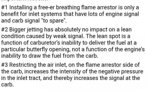

Yes large pilot of 145 gave me a little more low down bog. Hesitation goes. But still not right when hold full throttle. It should bog with too much fuel as I am using no high speed jet in my carb. After a lot of research I think I have found my fault. I believe I have a very weak carb signal due to my case porting but more so my inlet manifold. I'm running a protec mani with a crossover. I believe the carb signal is weekend by drawing air from two carb..it's basically bad on daul carbs with daul pulse lines so i read. This poor signal (low air velocity) is not able to draw fuel out the high speed circuit very well..hence changing the high speed jets made no difference. I will fill the cross over on mani Tuesday and test Wednesday/Thursday depending on work.

I have been told the stock cylinder transfers are not large enough to effectively handle any more case volume than stock. Not saying that is entirely your problem but I'd think it might play a part.

Anyway I can get the bottom end sorted. I can run a 135 on 1 turn with 21psi. But when moving onto high speed circuit it feels lean. So moved up jet sizes to try get a rich mixture on full throttle. the rich mixture never came no later how large I went on the jets. After reading a few post I found like you said a weak carb signal will not be able to draw out fuel out on full throttle and throwing every jet at it will make no difference because there is a weak carb signal. I believe this to be the large cross over on the protect mani as it's drawing from two carbs and that causes the a very weak signal so i have read.
People.are saying throw a bigger low speed jet in but if a 135 works well on that circuit why go higher. Going higher to a 145 low just gives me a very rich bottom end. Buts make very little to no effect on the high speed circuit. Because I believe there is not enough air speed going through the carbs to draw up fuel through the high speed circuits.
