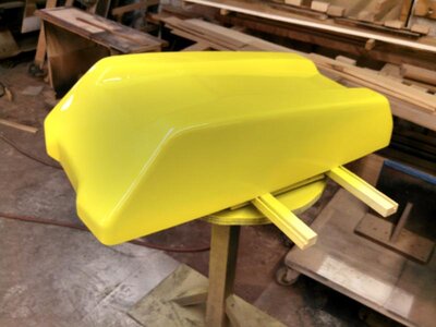

And on the 405th day, there was COLOR!!!
Well I got to finally apply the DayGlo Saturn Yellow paint on the hull. Holy :):):):)... What have I done!??!?!?
This paint is fairly transparent - as all fluorescents are I imagine. I've had this issue before - where if the base coat underneath it is not PERFECTLY white, you will see all the imperfects stark as day. So while I have the color on now - I'm going to spray a light coat of KILZ white primer over it unfortunately to get a perfect white coat - then put 3 or 4 coats of DayGlo over that - and THEN.... then it will be done!!!!
It's bright... really really really :):):):)ing bright. To the point where when riding it on a sunny day - it might hurt to look at. Hopefully the pole and turf will even the contrast out. Right now I'm almost thinking... did I go too far? haha
