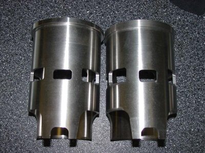

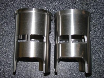

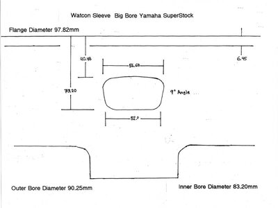

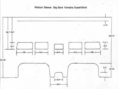

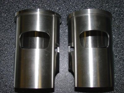

Scottie,I have northwest sleeves in that stroker motor that was at wavedaze,I dont know what is diff about the watcon ver though. Eric did say they were pretty slick,I think both ver have 2 mill lower port durations for stroker setups than 61x sleeves
