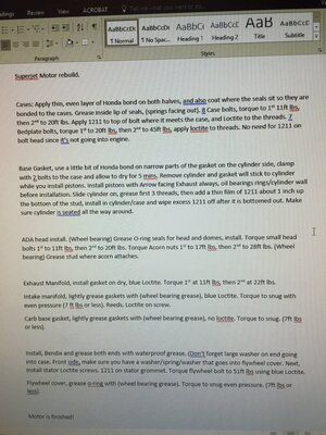

As others have said, the 61x/61x combo is a snappy, and super reliable package. It has been my motor of choice for surf for years now! I have built my 61x from stock bore to to 84mm (760) on the latest. They can be bored safely to 84mm, and in my opinion these little motors don't come to life until 83mm bore and porting (obviously with pipe and enhancer).
There are several options for you, in terms of top ends. Jetmaniac sells a drop in, moderately ported top end for pretty damn good price I think its $650. Or you can send your cylinder to Chuck Nuklear on here (CPT) who does great port work, and I have used him lately for several of my builds.
If you have yours apart, might as well send the top half of the cases to whomever is doing your work and have it ported also. (all of the little things, add up to performance gains). For pump gas, you want to be in the 180psi range in terms of dome size. Replace stock reed petals with Carbontech (made for 61x) and drop on a single 46 mikuni, or Blackjack 44, bore B pipe manifold/headpipe to 50mm and you will have a great motor!.
The above is Perfectly matched with a 144 solas mag (good priced mag pump), and 10/16 hooker, reduction nozzle bored to 85mm.
Attached is my build, sheet that has served me well, for many many builds.

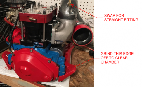

Finally done. Tomorrow she goes in the ski. Took me a while, but hey it was my first motor build....
Looks good! But what is going on under all the electrical tape on the stator harness?
Someone else had cut the stator harness at some point... The connections were all corroded so I redid them and put heat shrink on each one. I just didn’t have any heat shrink large enough to cover all the wires.
Should I be worried about this?
yamanube
This Is The Way
Mandalor
If you are going to ride in saltwater...yes. There's probably no reason to pull it apart until you test it, but bring a rope (and a buddy).
