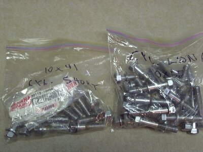

P1050162.JPG this is the real thing. Capscrews are not ss but chrome plated steel- has some advantages like less stretch. The 4 short ones are 10-1.25 x 40mm (actually 41), the 2 long ones 10-1.25 x 55mm. @JetManiac should have them. If not, I do.
