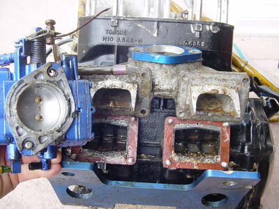

That is an Ocean Pro bed plate. I have one just like it. There is one on eBay right now if you want to see what they sell for.
The carb is probably a Keihin 42mm. Measure it where it bolts down to the manifold. I know for a fact it is a Keihin but it could be a 40 or 38 mm as well.
The manifold it a 44 Mikuni SBN style. It has an adapter to make a Keihin bolt up to it. You could sell if for some decent money if you cleaned it up good. Looks to have built in stuffers.

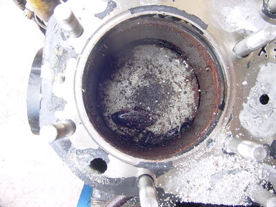

I just got back in from more tear down on the engine.
The engine is shot. It really sucks that whoever had this before me was so retarded as to not leave the plugs in it. There is no problems with the exhaust or the intake, all of the water came in through the plug holes and now the entire engine is wiped. Still have some good parts from fly wheel, what I think is in Bendix (the internal part of the starter system), the starter works, and I easily got the studs out for the head.

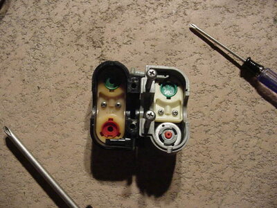

I can't believe how easy adding a laynard to my ski is. I held off ebcause I thought I was going to have to wire all kinds of stuff. NO! It's the exact same thing as the stock switch except for the laynard button. It's set up so that when the laynard is pulled, it presses the stop button. It's not like a couch set up. I don't even have to install the switch. I just take off the stock cover, and put the laynard cover on top. I can't believe it's that easy. After all the bull I've had to mess with, this part is going to go on smooth.
Watch though... I wont be able to get the screws out of my switch, then they'll strip, get stuck on start, fire the ski, burn up the starter and keep the stop button from working and the engine will blow, just because, nothing can be easy.
The pic is the stock switch cover off a parts ski and the laynard switch cover off of a part ski. I can't believe these things are so expensive if bought new. Why can't they just sell the cover as an upgrade to the stock switch? Probably the same reason you have to buy a whole shock for a bad bushing. BS!!
And yes... I realize the stock switch (left) I put back together up-side-down. W/E!! I'm not using it anyway.
omg. STOP YELLING AT ME!!
