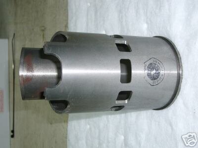

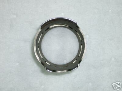

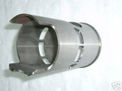

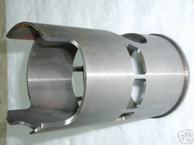

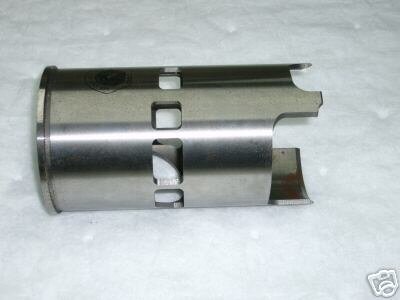

Here's some pictures of the LA-Sleeve for the GP-800
