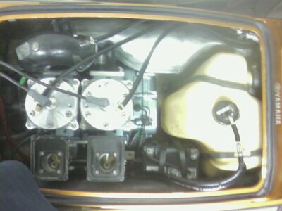

looks like a plate with an SXR/750 FP manifold.
But, the flywheel cover is a 61x/62T.
Plus no PV's
shannigans

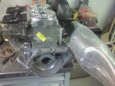

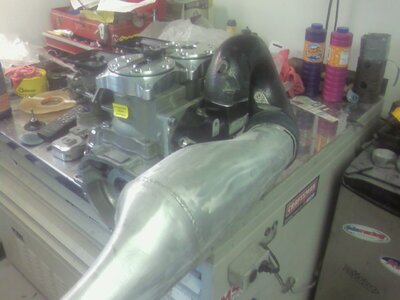

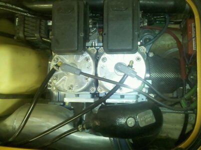

I wonted to try and see if it would work/fit its a GP800 with 1300R non PV cylenders 84mm bore 62T totaloss pickup and flywheel, carbs are 46SBN running pumpgass. I had a yamaha B-pipe i sold the manifold bought a new SXR wetpipe manifold, me and a friend made the adapters i then drilled the water passages in them installed a .5 waterline and re drilled the pump that line feeds the manifold and a .375(OEM) feeds the headpipe. it was a fun project/cool. im also using 62t bedplates hope you enjoy
itl be interesting as to how this runs, is the kawi manifold the same distance to the centre of ports as the gpr exhaust ports are?
howd you get round this then?
