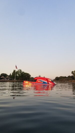

Actually using a 91’ 440.
19 will be good, 20 will be too tall for a stock 650.
Oh nice, 91 has rear exhaust. I have a clean 85, Im almost hesitant to swap it actually. Unfortunately I will have the noise coming out a big ole hose on the left haha

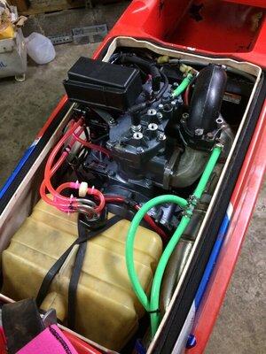

I did one about 4-5 years back, had a straight pitch 17* jetlyne impeller in it, worked fine.
