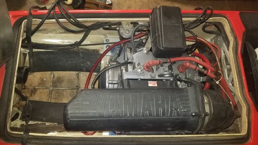

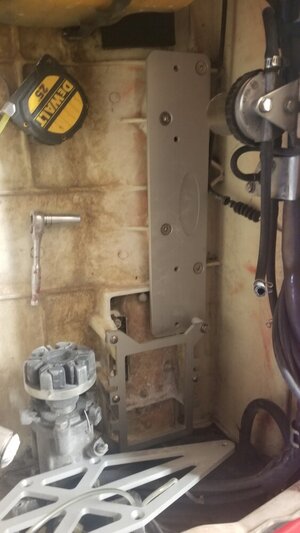

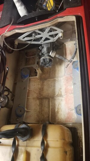

Got all of the kit in, and engine mocked up in there. The battery is not easy to access and it takes a different smaller size. Luckily the superjet engine fires instantly compared to a js550 so I'm not too worried about the smaller battery. I need to figure out what I am going to do for exhaust hose because for now I'm going to run a stock waterbox.

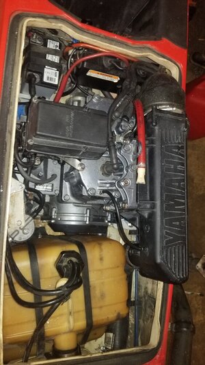

Update.
I got the engine in. Plumbed up cooling lines, wired, fuel lines plumbed, exhaust hooked to waterbox.
Getting the water line on was challenging because it's so close to the hull on the stock exhaust, and the ski is narrower than a sj.
I got a radiator hose from oreillys that was 2.25 tapered to 2.0 inches the sj exhaust is 2.25 and the js550 waterbox is 1.75. So I put a clamp on and just squeezed it down. Seems solid to me, time will tell.
One concern I have is the back of the exhaust is touching the ebox. I took the nylon spacer off the mount so the ebox can be closer to adapter plate. I know others have run this pipe in here with the rhaas kit, maybe they can chime in.
It fires up like every js550 wishes it could fire up. Probably try to test on it today or tomorrow.

The exhaust hose survived the first outing. I dont think it will be an issue, I had to basically do the same thing when I put a wetjet pipe in my superjet, it's had at least 10 tanks of gas put through it, and the hose looks fine on the superjet.
One thing I discovered was it has some vibration. Maybe it's the polyurethane motor mounts, I've heard they can cause vibration. Or it could be that I hadn't trimmed the hood vent enough and it was up against the exhaust. I will recheck and make sure the couplers are lined up correctly as well.
The ski definitely feels more significant as far as weight goes, but not in a bad way. Much better throttle response! I need to do more fine tuning, and I ordered a R and D aquavane to help the pump stay wet.
I rode my bone stock 1985 550 right after. I'm not sure how I used to ride stock 550s, I mean they are still fun, but definitely need more throttle response and power.
I also was looking at the ski this morning before work and realized I had disconnected the primer when I pulled the 550. But never plugged the "t" where it came out of the fuel line. How it ran as well as it did with that fuel line basically pulling air in with fuel I have no clue? I'm lucky it didnt seize or even overheat. But I'm guessing that is contributing to my vibration.
