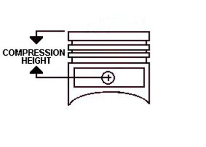

The piston compression height is measured from the wrist pin center line to the edge of the compression surface.
Pistons with a lower compression height rock less in the same bore and don't require longer skirts.

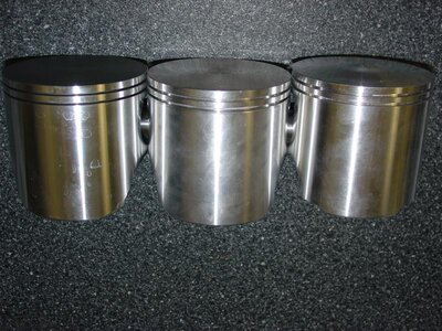

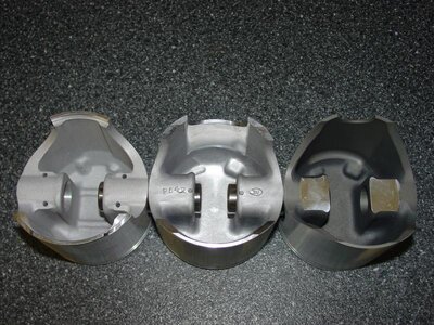

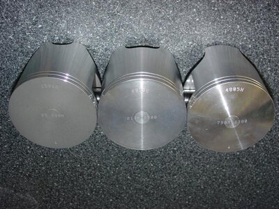

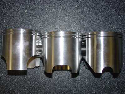

Here's a Riva flat top, Kawi flat top and Wiseco dome piston.
The flat tops are 3.8mm lower in compression height and raise the port timing and the longer rods slow down the piston speed which changes the dwell time.

my digital verniers must be wrong then
