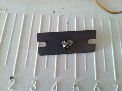

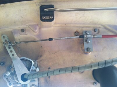

Looks like an updated version of the one I have, It allows you to offset the steering cable mount on the hood side to keep the cable aligned correctly. With the amount of additional throw you will get on this setup, its definitely necessary.

im with zimmy def looks like the offset plate that is much needed when you run in the last few holes. i have mine 3 in from the end and with out that plate my cable was way to kinked

This steering system is awesome. Everyone with a blaster should have one. Started 3rd hole from the end and then moved it all the way out. Incredible response with no slop. Used RRP 50mm rise bars which are prefect.
