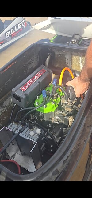

Anyway, Just wanting to share the project I've been putting together for my two boys. They've ridden skis with me ever since they were old enough to wear a lifejacket and they have been talking non stop about getting a ski they can ride by themselves. I have a place we can safely do that and the ski is setup where it will have an adjustable throttle limit.
2017 SXR 1500 hull and we dropped in a 701 61x engine I had laying around. Pretty simple and straightforward swap. We used a spark gas tank and I added 3 fittings to it. ADA couplers and it aligned perfect. Still using the stock 1500 pump/prop. First watertest was suprising as the ski went 38.5mph with the stock 1500 prop and the engine was being lugged down a bunch probably missing 2k rpm at wot (to be expected). Anyway, I think this is going to work perfect for what it is intended for and maybe one day we will swap an 1100 in it.
