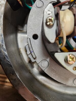

In the pic, the top line is the original (bogging real bad), the bottom is the position it's in now, the middle line is what I copied (as best I could) from the geometry of the stock stator I pulled off it.

That stator might not even be any good too, Been there!
Be cheaper to buy a good used one from jetmanic and be done with it..
For timing I use a positive piston stop and or a special dial indicator thru spark plug hole, timing pointer, timing tape and a timing light, cut stock flywheel cover, degree wheel..
Transferiering the mark over should have worked…
I’ve had bad cdi’s also cause loss of RPM and cut out before fully reving out..
You’re going in the retarded direction on your timing, throw that thing out or return it and buy from JM before the motor blows up.

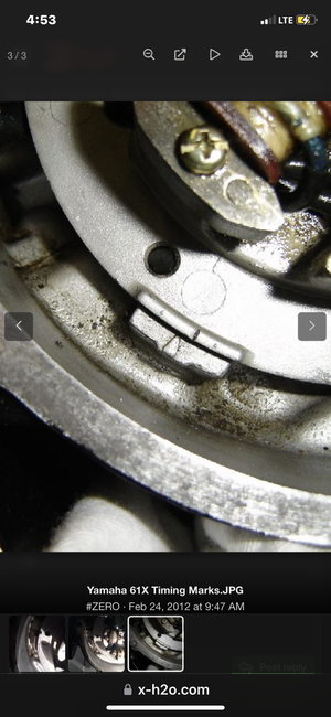

This pic is 3 deg advance

I didn't read anything here but line up the marks for standard timing. For every mm turned it either advances or retards about 1 degree. Turning the stator plate against rotation, advances timing just like turning the distributor on a car. Turn it 5mm advanced and it'll give you a hair more snap off the bottom.
