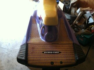

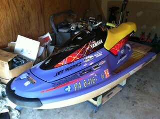

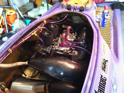

Haven't updated this in a while and wanted to post some pics of the finished product. Now have blackjack 44s and mag pump. New turf and waiting on quicksteer. This thing really rips now.
