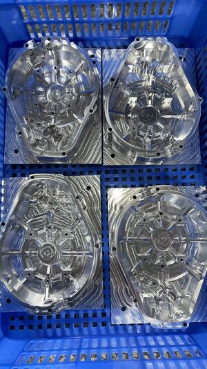

About three weeks out
Running a Zeeltronic ignition system and a bilge pump while idling in surf conditions can lead to a charging deficit in the ski, gradually depleting battery capacity and resulting in start-up and performance issues. Although the Zeeltronic ignition is among the best, it requires stable voltage to function optimally. To address this, we developed a twin charge coil front cover modification.
This approach replaces the redundant coil on the Yamaha 760 front cover with an additional charging coil and incorporates an extra Yamaha regulator mounted over the original. After connecting the supplied terminals to two snipped wires, this setup effectively doubles the ski’s charging capacity, ensuring consistent performance even in challenging conditions.
