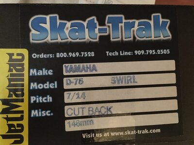

I don't think it's the pump fellas even the 11/17 that my ski came with felt good in my pump with a mild 701.
when you assemble the pump did you put any sealant between the stator, wear ring and pumpshoe? Im gonna be running a 7/14 solas in my 771, not sure how well a 9/15 would do with how small our krash reduction nozzels are..
Chris did the assembly of the pump. I fixed the problem I was having with smoke coming out of the pissers. It definitely hits harder than a 701, but still not enough. Local riding buddies think it's the prop, I have good midrange but not much bottom end. Impros also told me to go with a 7/14, sucks because originally they told me to go with a 9/15

what waterbox were you running before and whos prop is it a skat?
