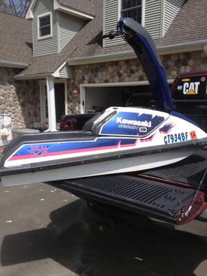

hey guys new to the forum and new to older skis i have an 06 800sxr but i recently bought a 94' 650sx big plans for this thing, so here are a few questions what do you guys normally mix your gas at in these and what type of 2stroke oil do you use? the motor thats in the ski now came out of an x2 so it has the dual carb and im trying to find parts for this thing the guy who put it together was kind of a hack needs new exhuast gasket on the riser part need a new throttle cable its pretty loose, could prob use a carb rebuild kit or kits seeing as its got duals any help would be great im going to remove all the deals some how haha and paint it all black with a candy apple red/maroon pole and last but not least is it possible to swap a 750 big pin into this hull? thanks for the help guys

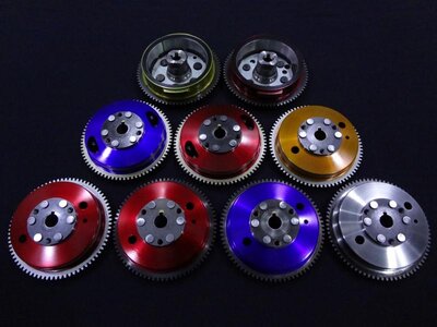

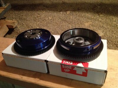

lighten your flywheel or get a closed magnet aluminum flywheel

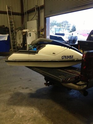

it has an after market pole spring im pretty sure because the pole weighs nothing an i have a spare spring i got with it, this thing is loud as can be im pretty sure the guy who owned it before bypassed the balled or what ever its actually called thats ahead of the tank, iv been trying to find gaskets for the exhuast and dual carb set up but havnt really had any luck with the carb ones, also do they make any sort of rub rail kits wwith more of a round style to it?

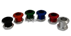

you need some of these annodized fitting for the large bow and tail hook holes
i would do blue or black it will give it a new look and feel front and back
