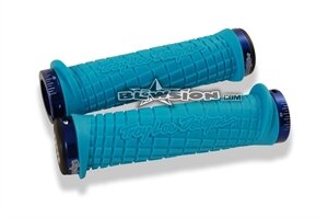

I would do black grips though

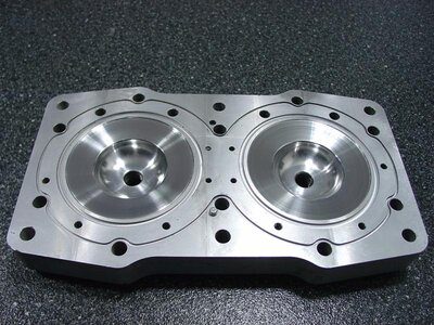

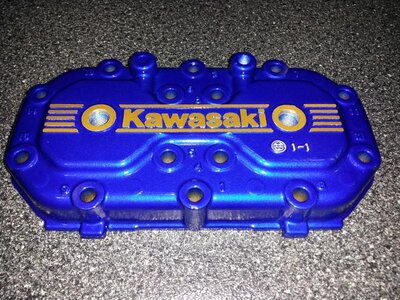

mill youtr head atleast .30thou it will require premium . put the stock waterbox back in it there 30bucks

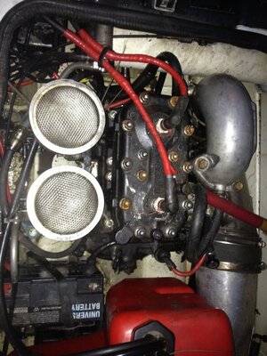

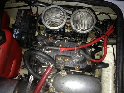

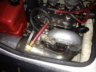

since its got the dual carb set up should i be looking for parts for an x2 or or cables and most things interchangeable?
what carbs do you have? some of the stuff is interchangeable your stering should be lose and flop around.
you can try this stuff called t-9 its aerospace grade 10 better than wd40.
you already got the pole up spray it in the cable down the barrel and work it lose then let it sit over night also tilt the back of the ski up as high as possible and spray that end getting the lube down the cable and let it sit overnight then re spray and your cable will lossen and should be ok but new cables are cheap , get them for your 650sx to elliminate any problems
big pins a good motor it has raised ports so its basiclly mild ported i would say @75hp stock compared to 52 of the 650sx but if you dont run a factory limiteded pipe or the nynja c4 its a waste
if you ran a 650 pipe on that big pin you would drop to 64hp roughly

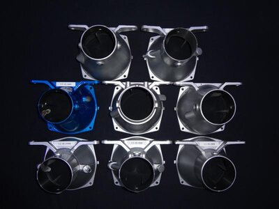

5. Stubby pump cone.
6. Milled head. bump it up to 180 psi. It will cost 90 because squich needs to redone. mcn6 on pwctoday does this well.
