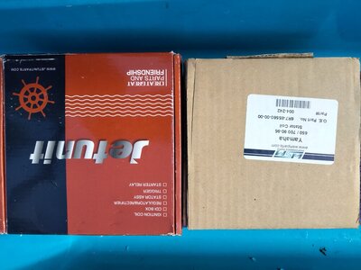

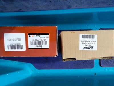

It was the stator!!! Installed the OEM charge coil to the old stator and Rev up first try.
I had no experience with Chinese knock offs. I worked for a dealer years back and we only used OEM parts. It was my brother-in-law who was riding it when it happened and he bought the parts. I finally ordered the charge coil from Yamaha and it worked. I was right the whole time because I didn't like the workmanship of the Chinese stator. Here's what he bought. I may make a post about this experience later to warn others.

Jets ski are like computers garbage in , garbage out. 9 times out of ten you are better off with a used OEM part than a brand new Chinese made crap.
