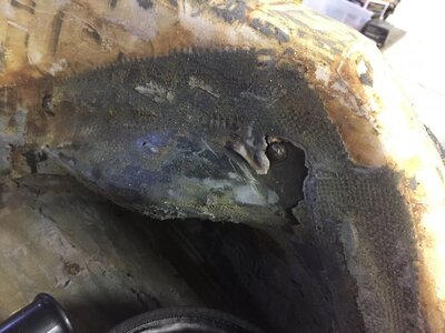

Got quite a bit of sanding and prep done today. Placed my US composites order yesterday, can't wait till this part is done and I get to start the glass work.
The deeper I get into this the more of a basket case it becomes. There are cracks all over the place. Gonna reinforce the side walls and sand down the crappy job someone else did.
