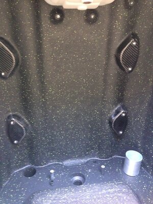

image.jpeg That's the inside of my phantom hull from @sinisterjosh209 4K for fiberglass hull no trimming needed or hooks to install the only thing you will need is rn mid shaft housing press out your mid shaft and put it in a rn housing, then a handlepole and me I bought an oem 155 pump for like $100 but you could run a oem 144 as well. Great deal if you ask any of us phantom owners
View attachment 297213 That's the inside of my phantom hull from @sinisterjosh209 4K for fiberglass hull no trimming needed or hooks to install the only thing you will need is rn mid shaft housing press out your mid shaft and put it in a rn housing, then a handlepole and me I bought an oem 155 pump for like $100 but you could run a oem 144 as well. Great deal if you ask any of us phantom owners
U can run a blaster midshaft also. As long as it isn't the wierd squarenose pattern
