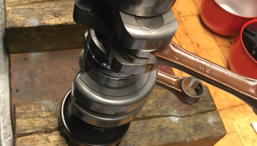

So in one of my engines i had a PHP 4mm light weight crank.
I had the crank out after 5 hours ride time, since new and had at 2/10 of an mm (Yamaha OEM spec is 0.5/10)
My buddy @stefan brought a brand new ADR 10mm crank over to show the nice run out.
Im pretty impressed with the ADR crank, and less impressed with the PHP crank to be honest.
Thoughts ? :)

I also did a messaruing on the same spot on the PHP crank (tip of taper, flywheel side) Same result. I was expecting a bit more from a PHP crank. 4 times the runout of OEM yamaha spec. Not good enough if you ask me. Not a cheap crank.

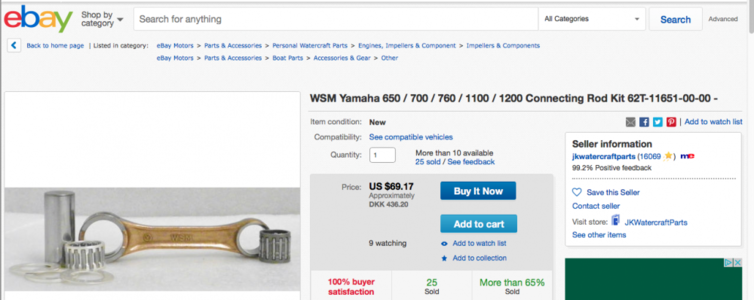

Oh yeah, also a bit surprised that the PHP uses WSM connection rods :)
Not exactly what i would expect from a high dollar light weight crank :)

I didn't say they were poop. Just i didn't expect a 69usd con rod kit on a crank to 1000usd+
ADR crank is what 200-300 usd dollar cheaper than the PHP, so that makes more sense they would use WSM rods.
I think the price of an crank would somehow reflect what parts they use. or maybe its just me :)

yeah, well i did not. it was run in for first hour, then 4 rides ridetime, no hydrolocking.
AND to add, that the best spec it could be trued to, was 0.05mm (wich is factory spec MAX)
I hve no ties with any brands, but think that there is to many people keeping information like this to them self or "hidden". While praising a product.
For example i dont get why PHP dosent advertise their crank with WSM rods. whie a lot of people are interested if cranks in general are with japanese or chinese bearrings.
Thats the best the PHP could be trued to, and Bo has done cranks lin 10-15 years. he can make them 100% straight, if its a good crank.
I will messuage the ADR crank when it has some hours on it, to see if it makes any difference ;)
