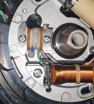

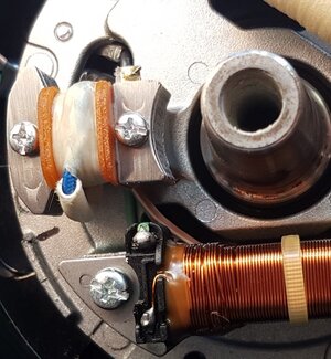

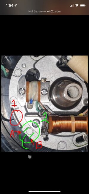

Sorry, my memory is vague, I wish I could find my pic I took.. but the detail I THINK I remember is that one of the green casting lines in #2 line up With the machined edge on the case... (A) is what I THINK I remember...
I’d say Your now within 5 deg of tdc.. either your at -5 or Tdc or +5
I’d use #2 and line up (A) then check your cranking timing with a timing light, spark plugs removed and grounded...this way it’s easier on engine to crank fast, no way backfire or kick back and destroy your Bendix/starter Testh. if you need more details on checking timing let me know...
That’s an expensive engine, I strongly suggest to very the timing with a light.
Note: if you line up B you won’t be accidentally advanced 5 deg.. sorry I can get you closer man

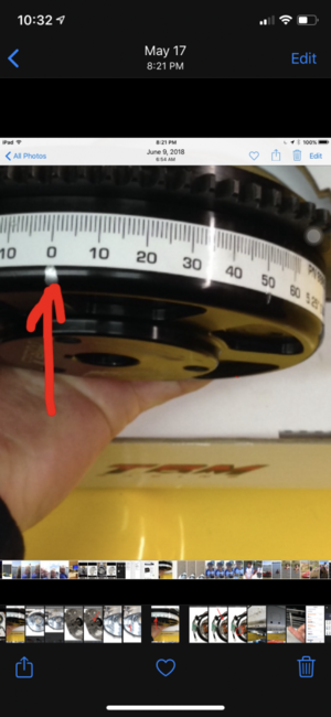

So you’ll have to decide which method your going to use to find TDC and index mark your flywheels TDC position. 2 methods to choose from, one is with a dial indicator and the other is with a degree wheel and pointer and positive position stop.... the dial indicator method requires less purchases I guess so we’ll go over that one.... you can buy it off eBay fairly cheap....pic of mine attached...
MSD instructions attached to find TDC with a dial....
See photo’s... once you’ve found TDC and marked your case tdc and flywheel tdc, see pic,
count to the right about 2.5 flywheel teeth and put a longer line, see pic....
That’s iabout 12 deg..... see pic,
each valley of flywheel tooth to the next valley of the next tooth is about 5 deg, see pic
So you can count out timing even over to 23 deg worth and put a mark....
If your using an msd enhancer the cranking timing should be about 12 deg and total running timing about 23 deg.....
As the engine is cranked the timing marks on flywheel will walk to the left if your facing the engine, and when running And brapping will go even further left as it advances and when rpm slows down it will retard and go right..
Since your flywheel has no marks you may want to paint Mark the tip of the tooth’s face instead of the valley so it’s closer to the case when your trying to view it with engine cranking... may be easier to see...

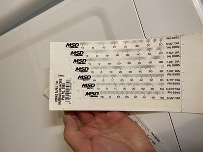

You can also use timing tape like this but it’s more stuff to order...
