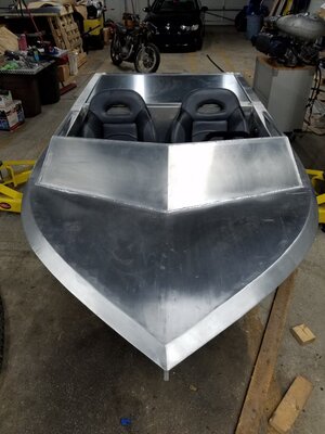

All aluminum jet boat
NH
Awesome! What engine/pump are you going to use?
Will be using the driveline from a 97 Waveraider 1100. Should make the swap super easy and clean because of the integrated e box the 1100's have. Also just put an entire pump setup in it last fall so I have a super clean 155 with trim to use.
