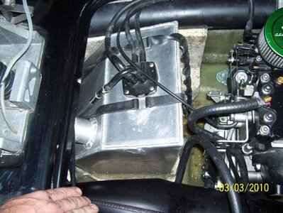

Here's some pics of the SXI pro tank I made. It won't fit in an SXR without some serious modifications, I already tried!

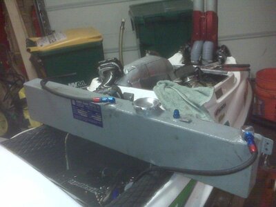

Nice, I had mine made by a guy in new jersey speedytanks.com. I added a secondary tank on the right side of the hull. I think it cost me around $275 or so. I used a wood mock up to figure out what size. Honestly, having roughly 7 gallons is great, but it gets a bit heavy when you first head out, oh well. It's kind of a pain filling it at times, but way better then a tow home.

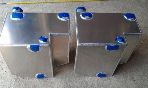

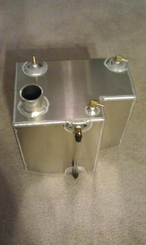

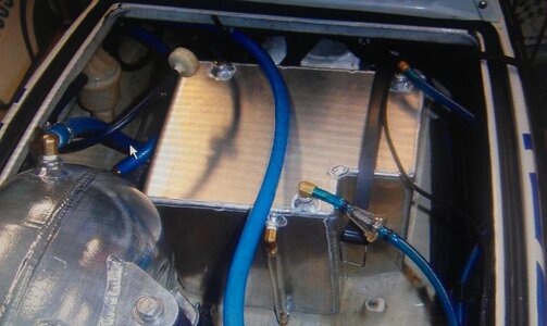

QuickMick
API 1104 AWS CWI
I have never had one of my tanks come back, or even been told that a sight glass tube is leaking. Once its on and sealed it should never leak.
Nice tank quick mick! I like the sight tube feature a lot, does that have potential of leaking or is that solid set up? Thanks, Dave
Off Site
Nice, looks like a sweet tank. I hate opening mine up to check level with waves rolling in to shore. I usually run it till motor cuts out then I flip to the main fuel tank, nice option for sure.
