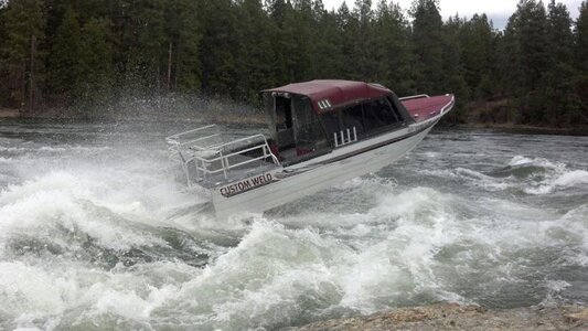

I don't see why it would be a issue, tons of ocean going boats are made of aluminum, just need anodes to resist corrosion. I think the weight would be close to that of a traditional surf hull with more strength. I am very pro aluminum coming from a river jet boating background. For me repairs would be easy, get a dent, knock it out, get a crack weld it up, way easier to repair than glass. I beat the sh*t out of my aluminum boats and they just keep coming back for more! I also don't see cost being much more that a glass aftermarket hull. I attached a pic of my 22' coming down a rapid, I would love to have a aluminum jetski hull just for this kind of river abuse!

Seems 509 and I are on the same page as far as river abuse..we do the same in my buddies boat hence my desire for a similar jetski hull...i cant begin to count how many times a traditional fiberglass hull would've blown to bits with the stuff we've hit in his boat...or even skid it right over/across sand/rock bars in the rivers.
