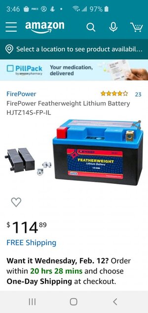

this is what i am running in my freak right now with a dasa 950, and in a small hard to get to space. i have two of these.
one fully died when i left my total loss on by mistake during end of season storage.... there was no bringing her back from the battery grave.
FirePower Featherweight Lithium Battery HJTZ14S-FP-IL
That's this oneScreenshot_20200206-154632_Amazon Shopping.jpg...
2 Year warranty.
Dimensions 6in. x 3 7/16in. x 3 11/16in..
C.C.A. 290.
Post Position + Left.
Yuasa Reference: YTZ12S / YTZ14S

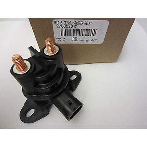

I am going on year 4 on my wps featherweight battery in my dvx. Spins over my php898 on race gas no problem. I have also had my relay get stuck twice and drain the battery pretty bad and its recovered both times. I am using the ballistic charger.
Ill look tonight for the dimensions.
which relay are you using?

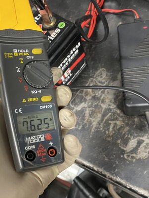

This looks exactly like the cheapo battery I have been frying, cept mines blue. Same panel for testing voltage too.
Stockton
Is yours a little rectangle black box? If I recall they had a few different chargers back then with different amp ratings
Yes, I think we have the same units... I charged with it today and checked it’s charging amps... it’s 14.6 v and 7.625 amps, other times it was 7.75 so nearly 8.0 amps
I’ll post a pic of mine tomorrow, slightly different looking. It would have been 2014ish when I got mine from AG, shortly there after they moved to selling a different style. I really didn’t trust it because In that same year I was charging my 12 cell from my charging system Chan and the battery exploded. Sent it back to them along with the battery, they covered the battery but said the charger tested fine. I wrote it off as moisture in the battery case. Since then I put it on when I get back from the water, and periodically check battery voltage until the light turns green. I disconnect it, let it sit and settle for a half hour, then stick it back on until 14.4 is steady.
