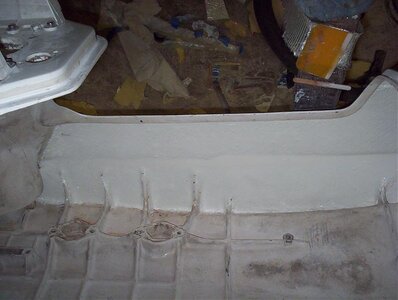

Quit reading my mind! I kinda want to try to get that done before Daytona. And the Aluminum Bedplate, and maybe just a bit of reinforcement on the left side for 3/4 rolls. I noticed I have a little crack showing.....
Hmmm, you mean this...... 17oz biax.

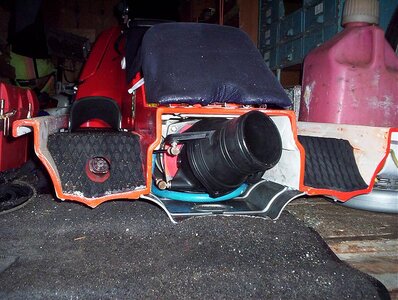

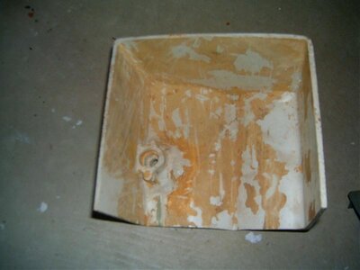

Pete, I can post up a pic of the inside of a hull. All the Kawie hulls have a places made into the fiberglass the hold a nut. Then they are covered in epoxy. It will be hard to mode an insert if you ask me. Maybe a hull repair insert will work.

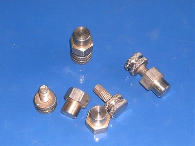

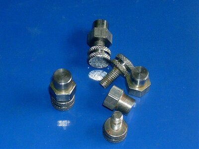

Pete here is the pics. The nuts in the second and third pics are what fit into those nut wells. The knurled bolts are out of the trim pieces/bumpers off of my old 650 SX.
