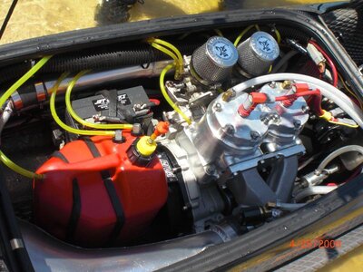

This is the only pic I have at the moment-pipe has been run 2 hours. Will come with EVERY part that it originally came with. Ex manifold has been ever so slightly port matched. Pipe is and looks like brand spankin new. It is NOT one of the 1 generation welded section chambers.
1100.00 + actual UPS shipping costs in the US only.
