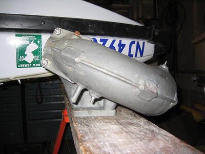

Will this type of head pipe work with a B pipe chamber?
Nope. The Pro-Tec headpipe has too tight of a bend and it would put the FP chamber is a wrong spot. The FP chamber mouth is actually slightly angled and the FP headpipe is pointing 5 or 7 degrees to the left.

Without more pics., just working off memory. I believe the Protec uses a jumper waterline from headpipe to chamber right? If this is the case you would have no water in the b-pipe chamber as there ar no where to jump water from the Protec headpipe. Even if it would physically fit, you would have to drill holes on inside of the headpipe and find a way to regulate it (like the B-pipe) to get water to the chamber.

Ok, so what headpipes WILL work with the factory pipes?
I know a coffman manifold will work with a factory HEADPIPE.
but what other combs will work?
I dont want to spend $250 on a headpipe.

What about the Coffman headpipe? It looks similar. But I think the coupler area is different.

You could put some restictors or jets in the fittings on the Coffman headpipe to regulate water like the Factory headpipe. I never tried it on mine before I sold it, but it should work.

I don't think it would fit.
Yep. I don't think the factory chamber would fit either. I think it's bigger around the coupler. You can restrict the water going in the Coffman headpipe to tune it. I never tried it on my 701 though. I tried a few different setups when I had it on the 650.
