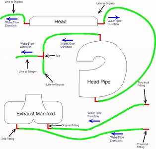

so one goes from pump to exhaust mani, then one from head to to head pipe at the bottom, then one from top of head pipe to stinger and out back into the water, am i reading that right? WHere does the other side of the head go to?
yea i have read that, but am i rihgt about how i am reading the water routing from that diagram? Im not to worried abotu valve control right now but does it have to be there?
how come i can only find 2 water screws on the head pipe for tuning on my pipe? did i get a older style or somehing? also the stinger is close to the gas ank if not touching right by the water box will this be alright?
Not old... just original. Matter of perspective.
However, there should be 1 or 2 small holes toward the exit end of the headpipe, inside. This allows continuous water flow. You may want to plug them. The later pipes (3 adjusters) allows control of flow through these.
