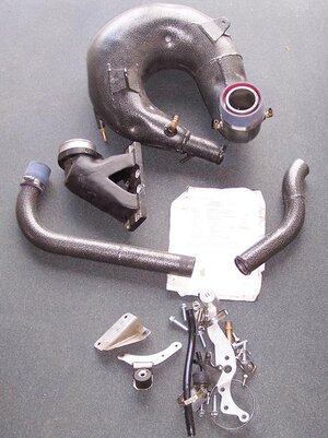

I was sold this as a blaster 1 dry pipe, I doubt it though. Can anybody id it.
