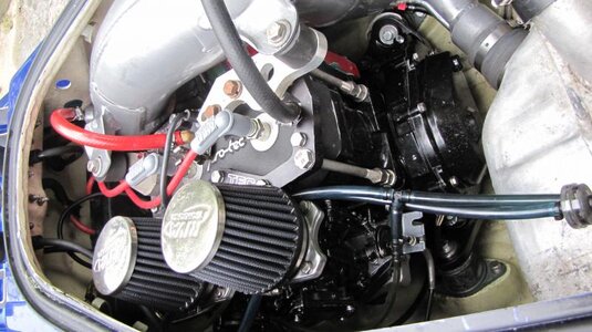

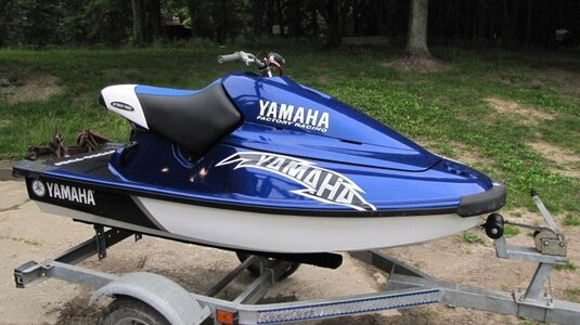

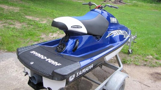

Well here is my winter project all shiny and new(kinda). And unfortunatly I have to let her go. Anyhow I hope you guys like it. Here what it's got.
'94 Blaster Fresh paint base/clear, New seat cover prof. install, motor is fresh less than a tank through it.
62T/61X 2mm over,5mm Protec crank(welded),cyl. and case ported by Protec,Protec head and girdle 200psi.(billet MRD head on the way to get the comp down to 185ish)
Riva Pipe and waterbox
New MSD CDI and Enhancer
Dual 44's w/Riva Fa's and Primer Jetting is Protec spec.
Protec ride plate and intake
Impeller aftermarket but I don't know what it is.

No I didn't paint it. My ex father in-law owns a chevy dealership and they did it in the body shop. The graphics are from ebay. I wasn't impressed with the quality. Must be bottom of the barrel 3M. Very thin and hard to put on. I even used alcohol/water mix and a heat gun and still couldn't get the large tuning fork graphic on. Not impressed at all especially for what they cost.
