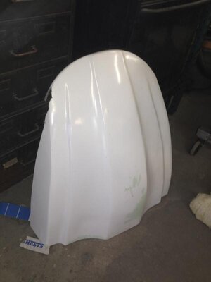

Here we go!!!!!!! Its cold outside, we are bored and have to many power tools. Starting out with a old blaster 1. Its stripped and ready for its make over. We shortened the rear -6, reinforced the rear. Puting a straight exhaust tube in, custom water box. We might end up running a superjet chamber, x-metal superjet water box and fule tank. Not sure just yet. We also are installing the new nose rocker kit that i got in from CarterB. Funny i also bought the one from the daytona raffle. We just got done with the rear and also fitted the nose. Its all glued up and we will start finish work on the bottom. We also will be reinforcing the side. Its gonna get a jetworks 830 stroker, 144 pump, and a thrust trim easy pull. I might have forgot somethings but will keep everyone posted.
