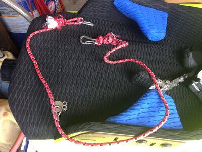

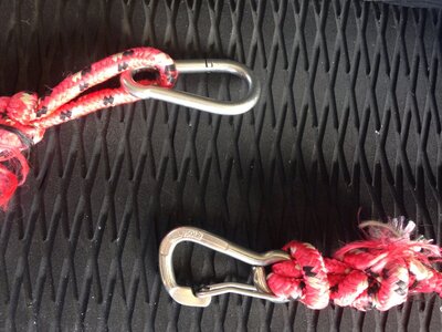

You guys have a good crew. The Buzzard came back for me last spring when my ski crapped out on me chasing boat wakes at CFW. Here's a pic of my tow rope. It has carabiners at either end. I wrap it around my waist twice and snap it on. Wear it like a belt. Super fast and easy to hook up skis with. image.jpgimage.jpg
