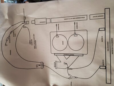

Anyone have an idea how i should run my cooling lines? I know i have 2 coming from the pump into the head. My pfp manifold has 2 extra outlets drilled out so the are 3 outlets on manifold and 1 at stinger. Would running the 2 extra to a tee then out the hull and run the other 2 regular outlets to their own pisser work? I have both 3/8 or 1/2 pissers i can use. Im using 1/2in from pump to head. I just don't know if that is too much or too little cooling
Sent from my SM-N975U using Tapatalk

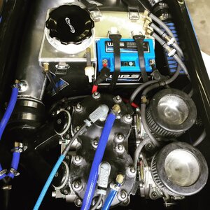

Maybe this pic will help. you can always plug the extra outlet. i am putting a xscream 1060 in my chan soon collecting a few more parts while motor is being built
