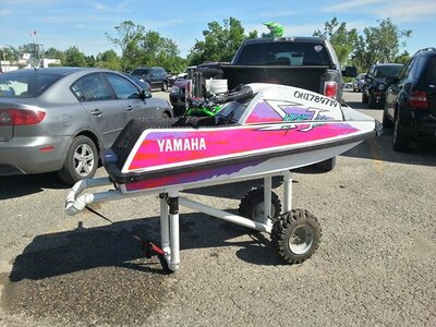

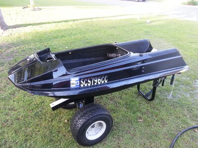

I picked up a set of nylon composite rims from Florida Sailcraft and stuck on a set of Carlisle Fairway Pro 18X8.50-8 4 Ply Golf Cart and ATV Tires.
This is the same setup that my TBM cart came with other than upgrading the 1" aluminum driveshaft to stainless and replacing the Nylon bushings every couple of seasons.
http://www.floridasailcraft.com/JetSkiAcc.htm
Nylon composite rim $40.00
Stainless axle $22.00
1” nylon wheel bushing $2.00
Best pic I have available at the moment.

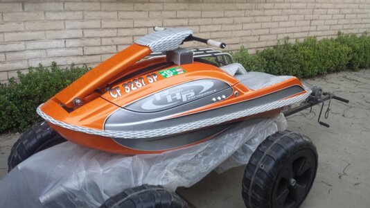

One were plastic Jeep Powerwheels wheels- good for hard pack like Daytona and regular land. Didn't float in the soft stuff though.
I've seen the Europe folks use four wheeled carts with what looks like these http://www.surpluscenter.com/Wheels/Wheel/Pneumatic-Wheels/7-5X2-INFLATABLE-TIRE-ASSY-1-1787.axd

What about plastic dock/boat lift wheels? Probably about as light as you're going to get.
