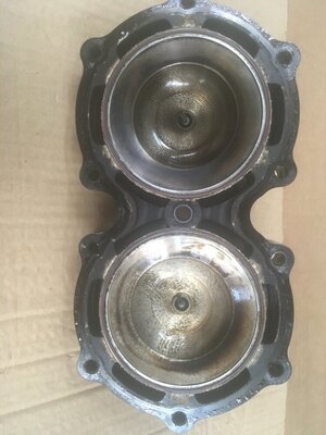

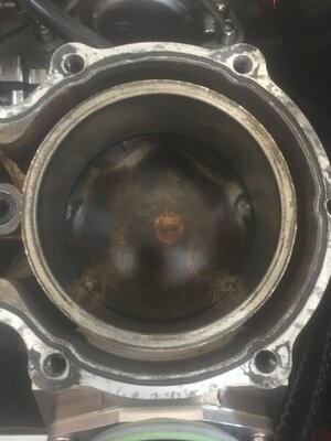

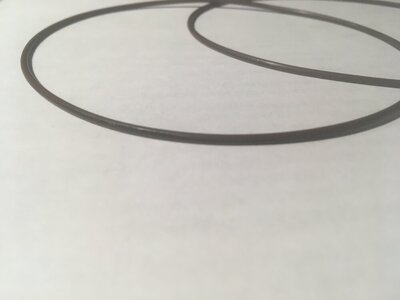

Figured it out. Hard to see in pics , bad orings, 40 gallons run time. Replaced them , returned High & Low screws to where they were when motor was zero time. Boat rips again, will run upside down, can reboard after rolling upright CLOCKWISE without having to restart. Can pull me up from laying over 90 degrees. The onset of this was so gradual at first I was able to tune it out with mixture screws. Should of been my first clue. Big Thanks to @Flash-FX for learning me quickly about orings, DOESN'T MATTER WHAT THEY LOOK LIKE, REPLACE THEM !!! Here's some pics.
Want to get some opinions on this. I did have bad dome rings and since replacing the boat is running great. The front and rear plugs still look different though. Is this normal? The rear plug always looks wet, like an oily wet, not a water wet. I do have rear mix screws turned in more than front. Does the PFP factor into this ( rear exh runner is straighter shot into cyl than front) ? How much different can/will you adjust mix screws? The plug on the right is the rear. It's hard to tell from pic but plug on right is actually wet, not powdery like front.

I had a similar situation, rear plug and piston wet and noticed my rear cylinder was running cooler than the front by 8 to 14 degrees, I forget exactly.. I spent a lot of time trying to isolate why…( thought it was the dribble out the rear carbs bomb sight causing it). Eventually I spun the carbs around on the speed plate and found the cold cylinder followed the carb, and the carb now on rear cylinder dribbled out the bomb sight when it didn’t wren mounted on front cylinder… That told me the fuel was entering below the throttle plate and cooling the cylinder, ( fuel exiting the idle circuit was not even in each carb for the same amount of (low screw turns out from closed)… so I retuned it, dealing with each cylinder and carb on there own…. It didn’t take much, maybe 1/8 turn or so in to get that rear cylinder to heat up…but I don’t remember the exact amount it needed..
I eventually found some uneven discoloration in the idle adjusters (low screws) seat between the 2 carbs..
