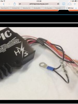

I am basically 'schooling' them. This seems to be from a lug that was crimped on instead of soldered. A few months ago the ski would have no spark sometimes, found the crimp-wings in the programming plug were shorting out to one of the pins. All problems are from things that should have been done differently during manufacturing.

The grounding lug on msd enhancers and epics are not soldered either. Get saltwater in your ebox and grounding issues are easily possible from corrosion on this critical connection. But if you solder it yourself then you risk voiding your warranty.

What exactly are you guys calling a lug? I know total loss like the back of my hand and I'm not picturing anything. Common grounding point? The wire connection inside the potting?

I'm trying to figure out how soldering a wire voids a warranty.
For the record I dont solder. I Suck At it. I use professional crimpers and bullets that I fill with grease or connect with weatherproof heat shrink connectors or connect to connection rings that I grease and heat shrink. Grease and heat shrink are my friends.

My atp came with those same connections all through the billet ebox. The first thing I did was redo all of them. Better safe than sorry. Glad you were sorted out. Atp was very helpful with every issue I have ever had with their ignitions which was always software issues except for the reflash I had to do after destroying a starter and bendix and knocking the ring off my flywheel. No problems after the re flash on my 1105.

hardware stores sell shrink wrap loop ends and bullets so you can crimp and then shrink wrap the connector. Rather than those cheap blue crimps in your pic here
Were those blue crimp ends from epic!? Lol
Heat shrinking is over rated. If you dont grease the bare wire before you crimp it, whats the point. Get heatshrink w adhesive inside if your going to use it. But just as you grease the male female connectors when you go through your ebox you need to grease the bare wire if you are putting a lug on.
