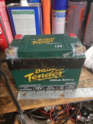

Here ya go
Thanks. That’s a lot of amp hours. Maybe I can find some old stock on eBay. Lim slip lists the new tank batt dem at 6.37 length mine is right at 6. Not sure if that measurement was takin turfed on both sides. I’m guessing it was and your not using turf. Those are the perfect Lipo mods to make a batt last. I also use a Lipo type charger
