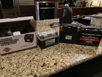

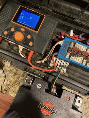

I see that one. I may try it. It's a bit tall. I'm looking at another from shoria that's SIM size but more ah. It's got a cell matching port as well. Just gotta think of a way to keep the port waterproof and assesable

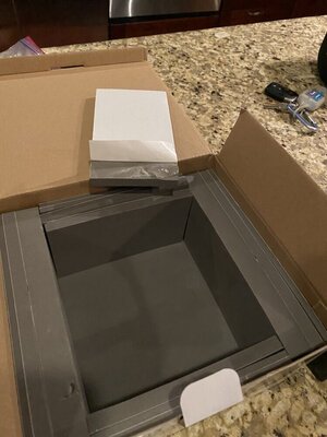

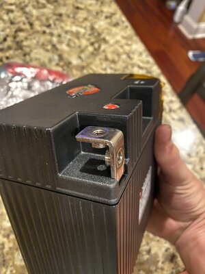

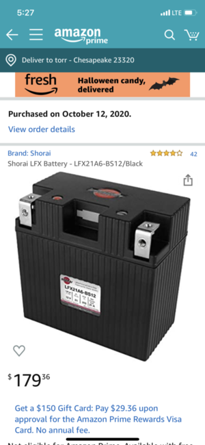

Here’s a great option. Fits well. Has plenty power 340cca 21 ah. Port to match cells. Super strong connectors. 5 yr warranty. Comes with whole box of sticky back foam to make perfect fit in tank. Less than 180 bucks
