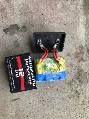

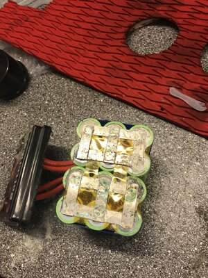

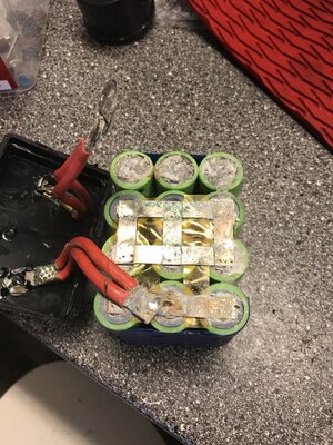

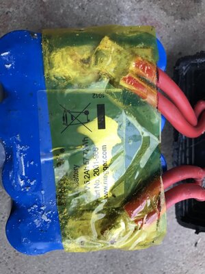

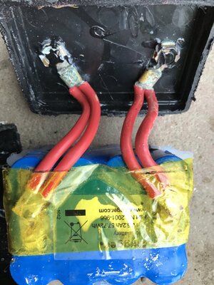

i put liquid electrical sealant/tape on terminals. BUT if you do put some sealant on, im pretty sure all warranty will fall. So the lithium i run now, i didn't do anything to - to be able to claim warranty if it goes dead.

^ Same here, after one went bad this year. The newer AG's have o-rings between terminal and case. A single layer of electrical tape around seam as insurance won't hurt and you can remove for warranty.
