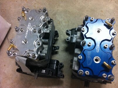

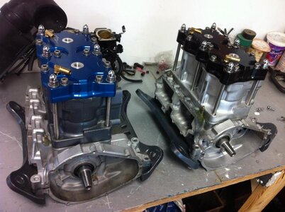

I can only take the case and the cylinder as a core. 250$ for the case/bolt and 100$ for the cylinder, both 62T and must be in good shape as well. Those price are shipped to my place in Canada. BB850 shortblock with prox piston is 3100$CAN + shipping and with wiseco piston is 3200$CAN + shipping, so if you send me you your case/cylinder as a core you will save around 300$ on those price.
Here the 2 engine who are available. They are the 4th and 5th engine we built. The first one was built in April of this year, run still that time and we had 0 problem at all. Same for the 2th and 3th.
If you have any question feel free to call me or text at 418-265-3571
Thanks, Remi
